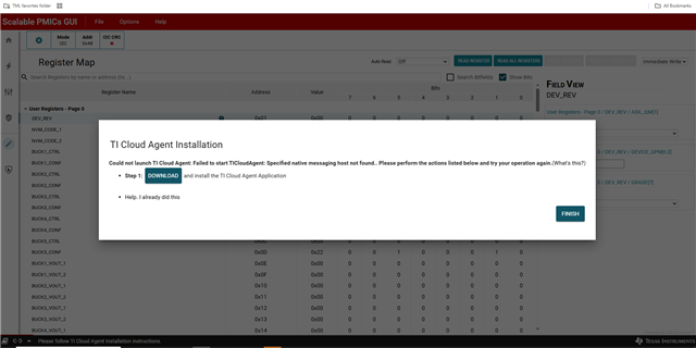

Are you asking where you can get the GUI for the TPS6593EVM? This is supported with the SCALABLE-PMIC-GUI, available here: https://dev.ti.com/gallery/view/PMIC/Scalable_PMICs_GUI/ver/5.0.0/
Are you getting a message when you try to open this GUI? Can you screenshot to show what it says?
Katie
Please find attached snap of error.
After installing TI cloud agent this window is coming every time.

Ok, so to clarify, it is not a GC runtime issue but a cloud agent issue.
Was TI Cloud Agent installed on your PC in the past by another user with administrator access? Does your account have administrator access?
Yes, TI cloud Agent was installed by using administrator access.
Ok so you installed it with admin access but is running the GC app from the same account as user?
I believe you are running into a known issue with TI Cloud Agent and a permissions conflict.
Can you (or someone who has admin access) log in to the PC with the admin account and then download and run the driver package in the link below:
https://software-dl.ti.com/ccs/esd/cloud/driver_pkg/
Then you can log in an rerun the ti cloud agent executable. However, if you are prompted for an admin account again, you can just ignore it.
