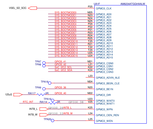

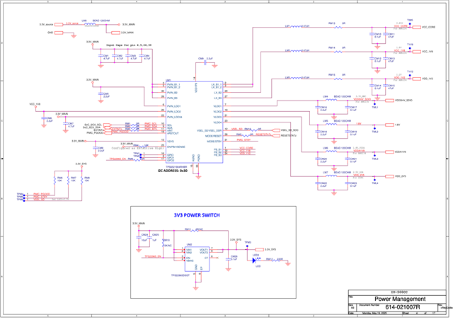

We refer to the circuit of EVM SK-62P-B1, which uses the TPS6521904 PMIC and is paired with the AM6234 CPU. According to the EVM test results, when booting from an SD card, the AM623's GPIO0_31 should output a "low" to the PMIC's VSEL_SD pin, causing the LDO1 output voltage VDDSHV_SDIO to switch from 3.3V to 1.8V.
However, when we use the EVM SD card to boot our own board, AM623's GPIO0_31 is not pulled to "low", but to a strange half-level position, making the LDO1 output voltage become about 2.5V.
We've conducted our own experiments: disconnecting the AM6234 from the PMIC's VSEL_SD pin. Simply pulling up the PMIC's VSEL_SD pin produces 3.3V, but pulling it down drops it to 2.8V. This seems to be a major issue. The relevant circuit diagram is shown below. Is there anything we can fix? Please help.

  • Hi
    But the EVM PVIN_LDO1 use 3V3_MAIN, not 1.8V. We did not use I2C to program the EVM, but the voltage can be changed.
    Your description seems a bit different from actual usage. Or is there something we are not doing right?

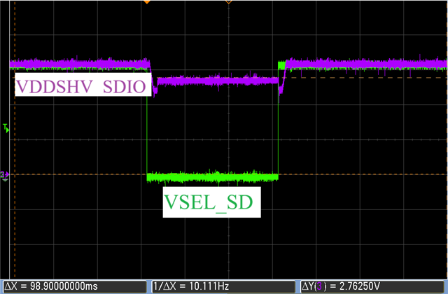

  • Hi Sarah
    The VDDSHV_SDIO only connection to AM623 VDDSHV5 & SD data pull up, no connection to other places.
    Also, please ask, the SD power supply VDD of EVM seems to have control timing, will this matter?
    And the VSEL_SD & VDDSHV_SIO state is as follows (In power on)
    Thanks.
  • Hi neil,
    Thanks for the confirmation.
    What do you mean by control timing?
    Have you tried replacing the PMIC on the board with another TPS6521904 PMIC to see if this issue persists?
    If this doesn't yield anything, I would like to try some I2C commands to further debug, if you are able to have this setup.
    Sarah

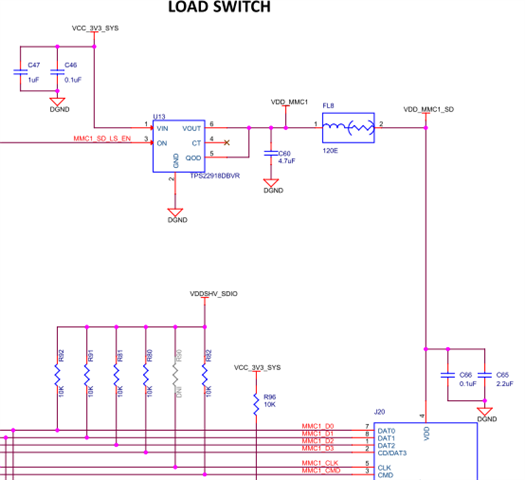

    "What do you mean by control timing?"
    Because EVB controls 3.3V on the SD through the load switch, I want to say whether it requires timing control?

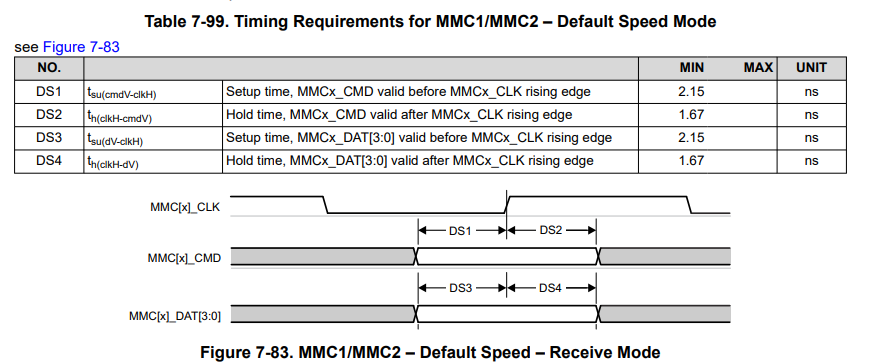

  • Hi neil,
    The SD / MMC1 of the AM623 may have some timing requirements. This would be more of a question for the AM62x team.
    I believe the AM62x datasheet has some details on the MMC1/MMC2 timing requirements, starting around page 193:
    VSEL pin does not have any timing requirements
