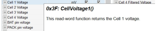

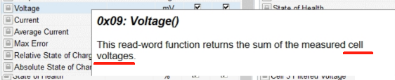

1.1. Is the cell voltage data from 0x3F or 0x007D?

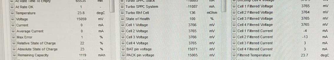

1.2. We observed during the test that Voltage VS sum of Cell 1~4 Filtered voltage = 0mV, but Voltage VS sum of Cell 1~4 voltage = -3mV
2. Under the effective static condition, how large of a voltage difference between the BAT pin and the PACK pin Voltage is considered normal?
3. What is the voltage accuracy of the BAT pin and the PACK pin?
