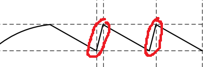

  • Hi Kazuki,
    The Iq in the datasheet is an average value. The boost current and PD current is instantaneous.
    The boost circuit will work in a hysteresis like this and only consumes current in rising edge. This helps in saving Iq.
    Same is true for PD pin, once it is fully enhanced, it doesnt consume current.
    Hence the Iq mentioned in datasheet is enough. Definition still hold true that Iq is the current flowing out of GND pin.
