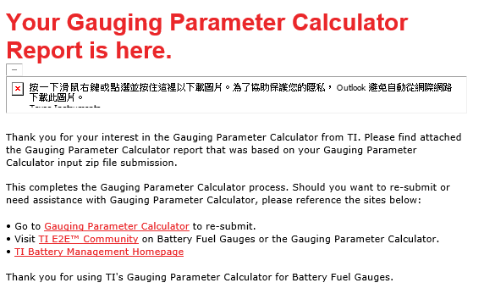

My GPCRB report shows as successful, but it appears to be missing some files (gg_out and chemdat12).
This doesn’t match my previous GPCRB reports.
Is this expected behavior? If so, how should I proceed with importing the new parameters?
The input file and the report are as attached.
0160.cell8115 GPCRB_2.zip
8512.cell8115 GPCRB_2-report.zip
Thank you

  • The tool didn't accept the gg file:
    "Due to GG file format issues, GG values have not been updated
    Warning: Automatic firmware properties detection failed. Rb_select defaults to 2. Please make sure that chem ID loaded in the GG file is the same as ID specified in the config.txt
    Warning: Automatic firmware properties detection failed. basescale defaults to 1. Please make sure that chem ID loaded in the GG file is the same as ID specified in the config.txt"
    Please make sure that you first program the ChemID (it needs to be unmodified, which means no learning cycle must have updated anything. Please make sure that you program the ChemID again before you extract the gg file) and that it's ChemID 8115 (or make sure that the config file has the correct ChemID - right now it's 8115).
