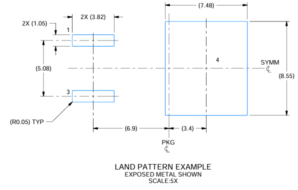

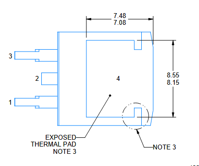

Looking at the datasheet for CSD19536KTT, there is a discrepancy regarding the pinout. The pinout for the schematic symbol shown on page one does not match the pinout shown on the package outline, footprint, and stencil drawings. What is the correct pinout for this device? Thanks!
