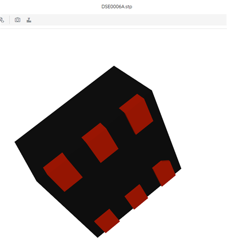

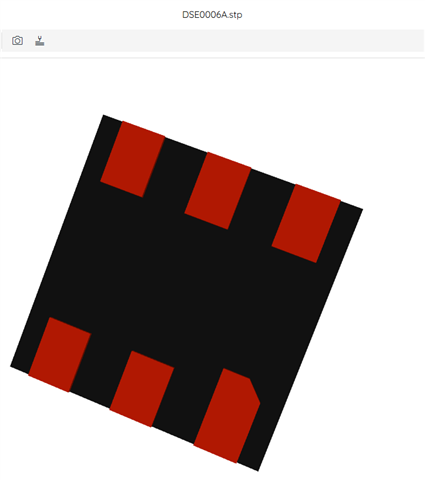

Hi team - Looking at the Ultra Librarian .stp file, it doesn't appear to reflect the actual package for the TPS3703-Q1.
Below is what we see from the step file:

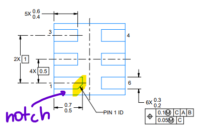

This more seems to match the footprint recommendation for the PCB and not the package's leads. See the package outline from the datasheet below:
Is the current Ultra Librarian .stp file correct?
