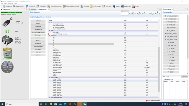

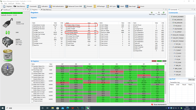

Hello, engineers at TI,
The aging test of the lithium iron phosphate battery has been completed, and the FCC shows that the updated value is 3603mAh. During the static process of the product, it is found that the FCC jumps to 4118mAh, but the Soc value of the product is correct. What may be the cause of the FCC jump during the static process of the product?
The attachment is the data of the aging test.
Aging test data.xlsx

    I looked into your gg file closer.There seems to be multiple protection events on this part. Did you test this part before? I also see a permanent fail (PF) of voltage on CELL1 of ~1V which is very low. If the voltage of one the cells is getting too low, it might be triggering the qualified discharge event. However, the part needs to remain on that EDV2 + ~256 mV voltage for a period of time.
    Can you elaborate what was the state of the gauge and the battery pack during "static"?
    Is this issue repeatable? If so, can you capture a log from Bqstudio I can take a look closer?
