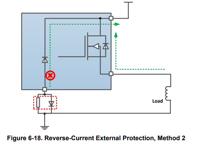

    1) Short to gnd shouldn't cause damage to the device however it may overheat and problems could occur if it operates in a short to gnd condition nominally

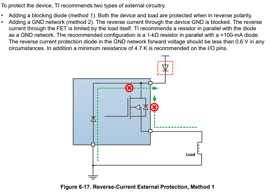

    2) Is their anything upstream of the device when the 24V are put on Vout?
    A reverse current condition could damage the device, are their any reverse current protections such as a blocking diode or a gnd network?

    We have not connected any diode for reverse polarity, When the output of the switch is 24V, client by unknowingly connected a different 24V supply to the output 24V., will this cause chip to burn out?

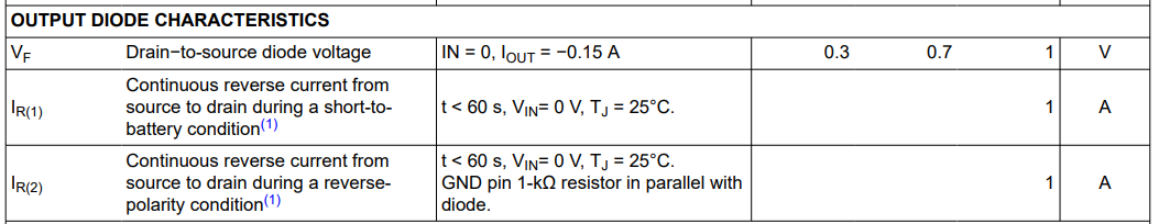

    If the device is off it can handle a reverse polarity for less than 1 minute:

    If the device is on and 24 volts is on OUT the main issue you will find is that the device is only allowed to have 1A of reverse current for 60s.
    This is because in a reverse current situation all of the protective features of the device are disabled so the current is able to go above the limit
