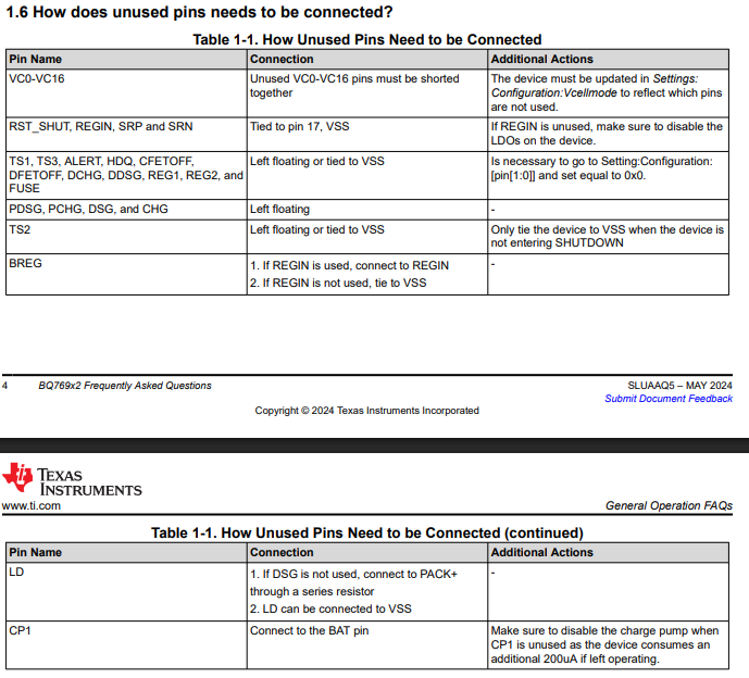

    Section 1.6 describes how to connect unused pins. If not using protection FETS you should follow the recommendations for the following pins: PDSG, PCHG, DSG, CHG, LD, and CP1.

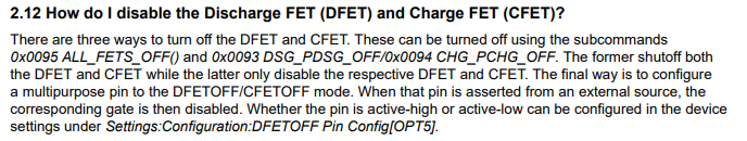

    You will also want to disable the Discharge and Charge FETs using the configuration registers, this is described in Section 2.12.

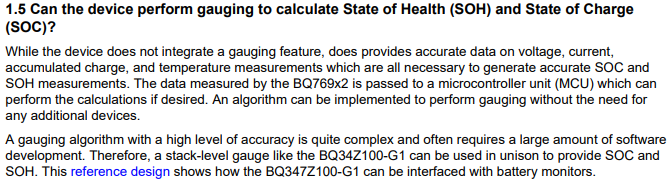

    As for the Fuel Gauging, the device doe not directly provide a State of Health (SOH) and State of Charge (SOC). But the data measured by the BQ769x2 can be passed to a microcontroller unit (MCU) which can perform the calculations for a gauging algorithm if desired. Section 1.5 describes this further.
