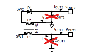

        We use LM5017 to design a fly buck circuit.The document SNVA674C shows the basic operating principle of the fly buck circuit.There are a few questions,please help us to confirm it.
1:In figure1,is IL1  refered to current in the primary winding and IL2 refered the current  to the secondary winding? and which waveform is the IL1?
                                                   Figure 1

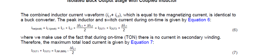

2:What is the magnetizing currrent reffered to? And what is the differences between the magnetizing current and the IL1 in the figure 2  ?
                                                 Figure 2

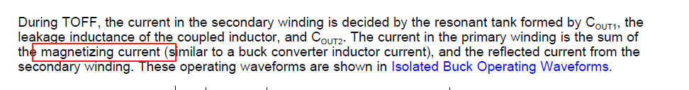

3:In figure 3,why is IL1 equal to Iout1 on a cycle-by-cycle average basis?
                                                 Figure 3

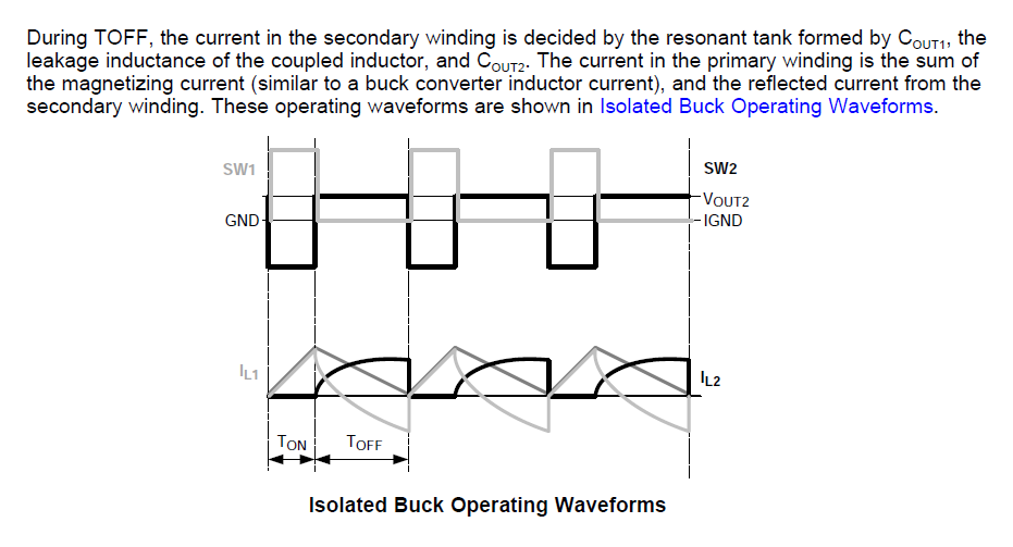

4:In figure 4,is ΔIL1 equal to 0?
                                                  Figure 4
