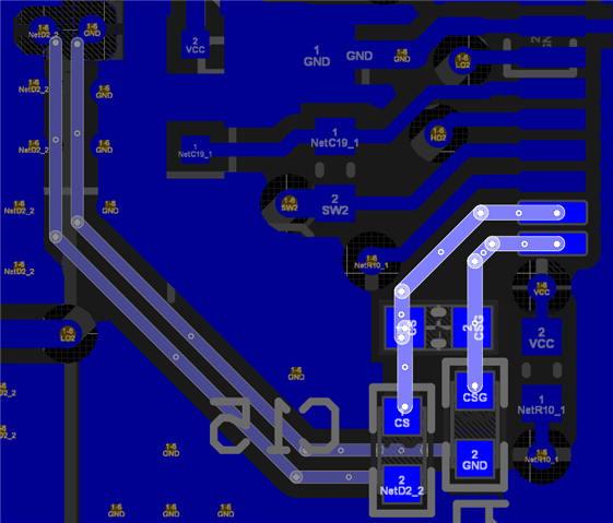

Dear TI experts,
My customer tests LM5175-Q1 in their own PCB, and they found that ripple is detected both input and output.
I think layout is something wrong, so I want you to check schematic and layout.
Just these files are confidential, so I want to send these files by private message.
Could you send me the friendship request? Then I will give schematic, layout and some test results.
Chase

  • Hi Chase,
    there are a few items which should be checked first.
    - The slope compensation capacitor is much higher then recommended
    - Thermal pad of the LM5175 has thermals which will have bad thermal connection and also add inductance
    - connection of the Sense Resistor R694 is not done as Kelvin connection. This can add additional noise in the sensing signal and disturbe the regulation.
    - phase margin is only 34 Degree
     Stefan
  • Hi Chase,
    please always drop a note in the thread - otherwise you might not get a reply for days or weeks as private message gets not checked regularly and can not be accessed by the whole apps team.
    - The slope compensation capacitor is much higher then recommended -> I will test the value as same as EVM.
    -> please do not use the value of the EVM but use the value which fits to your design based on the datasheet or quickstart calculator
    - Thermal pad of the LM5175 has thermals which will have bad thermal connection and also add inductance -> Does it mean that thermal pad of LM5175 have a bad connection to GND of PCB? and this bad connection caused additional inductance? Can I improve it through adding vias on GND pad?
    -> Vias can improve but would also use the out side layer for better thermal connection without using thermals for the thermal pad.
    - connection of the Sense Resistor R694 is not done as Kelvin connection. This can add additional noise in the sensing signal and disturb the regulation. -> I checked about Kelvin connection in google. but EVM is also not done as kelvin connection. Could you tell me why and give me ideal example for Kelvin connection?
    -> the EVM has a Kelvin connection to the shunt resistor on CS/CSB
    - phase margin is only 34 Degree -> How can I expand phase margin? Is it possible to change the values on the PCB? Or should I change PCB layout?
    -> phase margin can be adjusted by the compensation (components on the COMP pin) the quickstart calculator can help you on that
