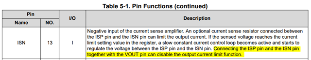

As said above, i will not use the current limit function, do i leave ISP and ISN open? Short to gnd? What are the rules.
Also, what do i do with the CDC pin?
Thanks in advance.
