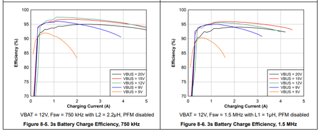

    Likely the charger die temp is reaching 120C and so the thermal regulation loop is limiting input current to prevent die temp from increasing further.
    The charger's efficiency when switching at 1.5MHz isn't high enough to reach 4.5A for a 3S battery from 20V input but it should be able to reach at when switching at 750kHz as shown below:
    Even at fsw=750kHz the charger die temp and therefore package will get hot.  You will need to increase inductor from 1uH to 2.2uH if switching at 750kHz.

    Thanks for the info... I just realised I was trying to make the BQ25798 system dissipate 4 watts of heat in sink mode and 1.5 watts of heat in source mode! No wonder they could've instantly heated past 120C! I'm reducing charging current to 1.5A and sourcing wattage to 18W (9V, 2A), in hopes that less than 1W of heat dissipation should work ok with my 4-layer design that uses 2oz of copper. I was overthinking things Sweat smile I'll let you know how it goes.

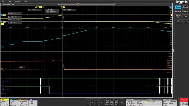

    I suspect that the 5V is dropping when you try to source more than 0.5A and the PD controller performs a hard reset when the UVLO threshold is reached and the reconnection results in the power role swap.
    Chris
  • Hi Chris,
    Before I create a new topic, I'll just add some additional context here for you, in case that helps.
    I tested changing the 5V PDO to 0.5A a few days ago in hopes that the source device wouldn't try to draw excessive power and it still didn't work - I suspected the same thing. Additionally, in my load testing today, the output voltage dropped only 0.15V on the source side as measured by the PowerZ C240 from 0A to 1A at 5V, which doesn't seem abnormal to me. I also tested with a separate board unit swapping out the buck converter circuit for a commercial buck converter module that supports 3A, and it still didn't work. PP5V measures 5.00 - 5.01V with a multimeter in rest. Could it be bad routing or lack of capacitance? Why would these things work in load tests but not with actual devices?
    Thank you. I will create the new topic if there are additional troubleshooting steps to be made and not a simple change that you might recommend.
    Yes.  If the power path is too narrow (more inductive/resistive) and/or if there is not sufficient capacitance then you would see the voltage drop during a transient.

    When I was testing with the PowerZ, my smart charger gradually ramped up the power, it wasn't one quick step from 0W to 5W or even from 0 to 35W like I was testing before. It ramps up the power over the course of like a second or two. What I still don't understand is how the same thing was happening when I used a different buck converter though. As I was saying, I copied TIDA-050047 component for component, so maybe there's enough capacitance, but the way I routed it renders that amount of capacitance essentially useless.

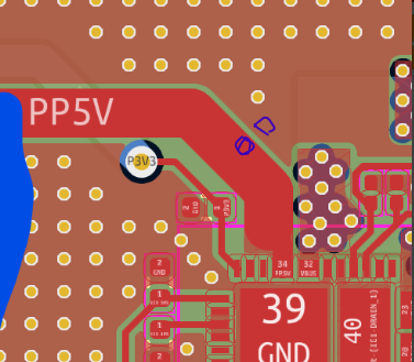

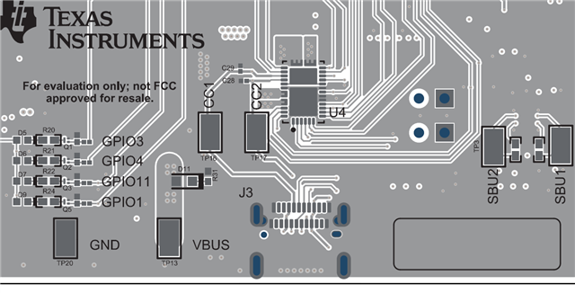

    USB-C connector routing. Might I need any additional capacitors other than the 4x 0.1uF and 1x 4.7uF that are already there? Do my 10 0.3mm hole vias at the narrowest part of VBUS add too much inductance? Top and bottom layers have 2oz copper.
    PP5V buck converter routing... The capacitors are to the side of the main power path... Now I'm obviously a beginner in PCB design, but I'm pretty sure, looking back, that's probably not the right way to do it. I don't know to what extent the effects of this poor routing would have though. Couldn't a fast enough transient pretty much evade these capacitors which could be a reason why the voltage would drop?
    What would happen if I cut and put a bodge wire as illustrated?

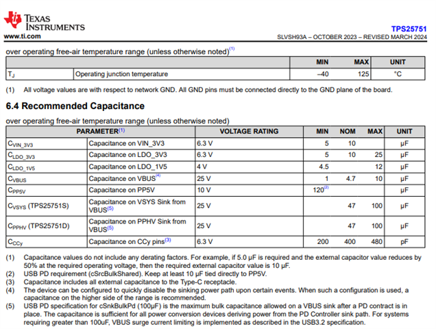

    No.  You should not need additional capactiance.
    I am not sure what is the component connecting C_VB and VBUS, but on the VBUS side you are using plenty of vias so i would not expect an issue.
    Do you know the rating of the cable and connector?
    https://www.ti.com/lit/ug/slvucp9a/slvucp9a.pdf#page=39
    I do not think that is necessary.  You have used a fairly large piece of copper.  You could attempt to expose the copper on the top layer and place a capacitor closer to PP5V but again I do not believe that would help.  Similarly you could move the 4.7uF from the C_VB connector to the VBUS at the PD
    - I would not risk cutting up your board.  Try and focus on the component between C_VB and VBUS and the connector/cable.

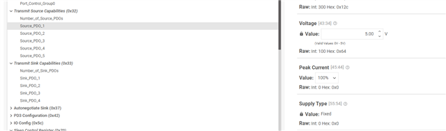

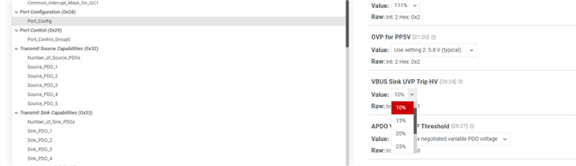

    You can adjust the VBUS Sink UVP trip threshold in the Port Configuration Register:
    Could it be something in register 0x77?
    Register 0x77 is the source capabilities extended Data block.  This is defined in the USBC-PD standard and can be used by the sink to understand the capabilies of the source.  These do not in any way gate the capabilities.  The idea is that the sink is made aware of the capabilities (limitations) of the source through the capabilities and extended capabilities message.
    You can also try increasing the peak current in the PDO.
    but, if we get source mode working, does it automatically support PPS too, or do we have to add that in in the Advanced Configuration page
    You will need to add the PDOs in the advanced configuration page.  By default an SPR AVS PDO is added.  You would need to enter an SPR PPS manually.
    Chris
    You can also attempt to set the PDO voltage slightly higher, 5.1V.

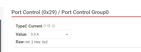

    The sourcing capability of the implicit contract is defined in the configuration: Type-C current.

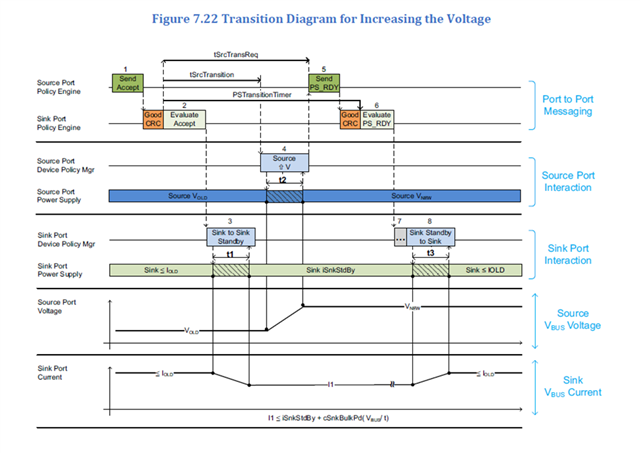

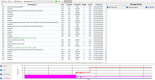

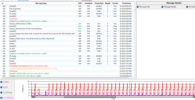

    I am testing with a constant E-load of 1A and able to source 5V.  When I transition to 9 or 15V then the PD controller appears to open the power path.  I repeated and saw the same results with 0.75A and 0.5A.  With no load the transition works without issue.  Per the PD specification the sink is not supposed to draw any current during the transition beyond 500mA.
    iSnkStdby  = 500mA
    tSnkStdby = 15ms
    What I think i am seeing is a system level issue between the PD and the BQ devices.  If I turn off the load before the transition and then turn the load back on after the transition, then there is no issues and I can source 15V at 1A.  Not sure if this makes sense and it would seem that I am diverging from how you are testing.
    Chris
  • Hi Chris,
    I am unsure if it is the exact same issue we are both experiencing, as I can draw up to 2.5A at 15V in source mode using my electronic load, however I am not drawing current during the transitions, and the dI/dt is probably quite slow compared to your system. It is a very budget test setup - a USB-C sink device is attached on the other end of the cable, which successfully requests and sinks a constant 15V before it is even plugged into the input of a smart battery charger that charges a battery at a certain current which I am using as the electronic load.
    Does your setup work when you plug it into a USB-C compatible consumer electronic device? With my iPhone 16, sourcing from the TPS + BQ system fails initially and then it role-swaps so that the phone sources power to charge the TPS + BQ system instead. Other sink-only PD-compatible devices (I don't have any devices which use proprietary charging protocols) simply keep ‘resetting’ after it appears power negotiation is successful.
    I was really confused about this because you would think that a budget electronic load setup would be less likely to work than the consumer electronic devices that TIDA-050047 was designed for, but I guess not in this scenario. I wonder what it is that is tripping the system up on the consumer electronic devices.
    Thank you.

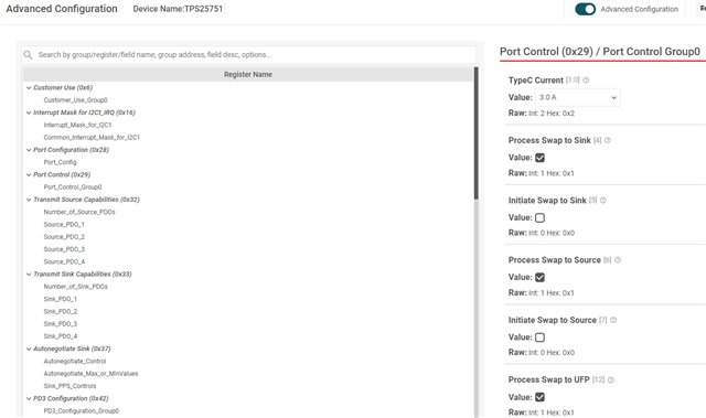

    I have a samsung phone and it performs the swap which sounds similar to what you may be seeing with the iphone.
    The initiate Swap to SInk is set in the configuration so it will always initiate a power role swap.
    If i clear that setting
    Chris
  • Hi Chris,
    Thank you so much! It 100% works now! Is it a bug or a feature that this setting is on by default? Out of curiosity, does it try to swap to a sink even with sink-only devices on the other side?
    Have a great weekend!
    This is a setting that comes from the questionnaire: do you prefer to be a source our sink.  This gets translated into the initiate and process swap (to source or sink).
    Yes.  If the far end device is sink only then that device would(should) reject the request to swap (from a sink to a source).  Because the phone is a DRP it is accepting the role swap request.  I think it would be beneficial to have another layer of intelligence to interrogate the far end before initiating a power role swap.  This unfortunately also increases the solution cost.
