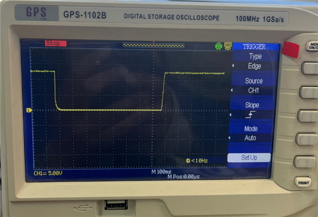

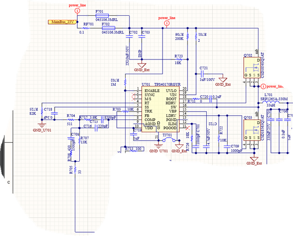

Hello everyone,
I have implemented the TPS40170 according to the attached schematic. My input is 20 V and the output is 12 V @ 3 A.
With purely resistive loads the converter works perfectly. However, when I connect an electronic device whose supply input contains a capacitor, the converter momentarily shuts down and then restarts. I captured this behaviour on the oscilloscope — see the first attached image.

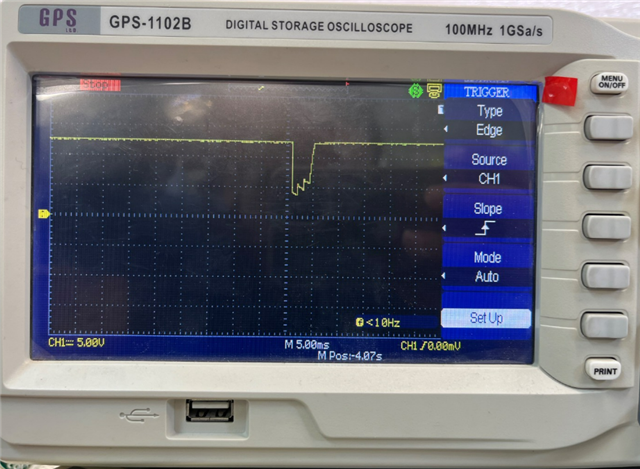

After multiple tests I concluded that the issue is related to current protection / soft-start behaviour. Adding a soft-start capacitor did not fix the problem; in fact it increased the duration the converter stayed off. In the next test I completely removed the soft-start capacitor and also removed the resistor used for current limiting. The result is shown in the second attached image: the converter still shuts down, but the off time is much shorter.
The electronic systems I intend to power are sensitive, and these momentary shutdowns cause serious problems for them. Please advise on possible causes and recommended fixes (e.g. changes to soft-start, current-limit settings, snubbing, inrush control, layout issues, or other design considerations).

  • Hi Jacob,
    This is current limit engaging due to the capacitive load. Ideally, you would use a CC/CV circuit to limit the current - take a look at the LM5190 controller.
    Tim

  • Jacob,
    Consider adding an external constant-current (CC) circuit to manage the capacitive load. Otherwise, it is difficult to limit the current spike without triggering the current limit. The TPS40170 only provides output voltage regulation.
    I recommend filling out the design calculator for this controller to check where is the current limit setpoint relative to the full-load current rating.

  • Maybe increase the current limit setpoint (but don't go above the inductor sat current rating).
  • My ILIM resistor is currently 150kΩ, and the capacitive load connected to it is around 220µF. The same issue still persists and has not been resolved. A 220µF capacitor is not a large value, so this behavior of the converter is quite surprising to me.
    In any case, increasing the ILIM resistance hasn’t helped. I would appreciate it if you could suggest another solution to resolve this issue, as changing the IC is not an option at this moment.
  • 220uF is a huge value at 12Vout, especially if the cap is instantaneously connected. Is there a way to connect the capacitive load gradually or before startup? Otherwise, there will be a huge current spike into the cap, resulting in power stage component stress and ground bounce. Note also that compensation needs to be verified both with and without the cap to ensure stability.

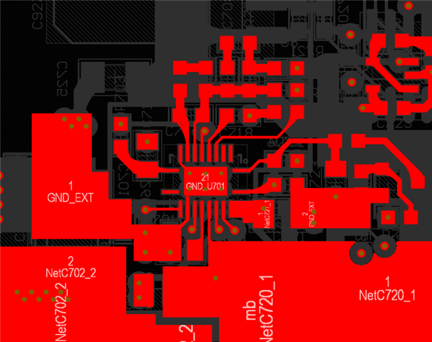

  • Have you got a waveform to see how severe the current spike is? Send on the PCB layout as well.
    Anything you can do to slow up the application of the load is helpful.
  • this is my pcb layout
  • Do you think adding a snubber to this converter would improve the situation or not?
  • A snubber slows down the switching edges. I doubt it would have any impact.
