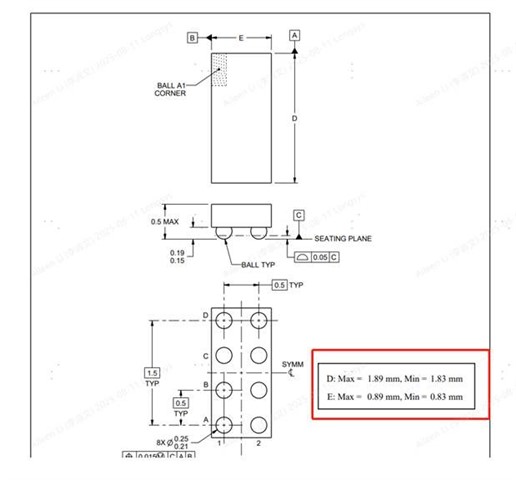

Hi ti team,
There are two inconsistent pieces of package dimension information in the datasheet of TPS22971, as shown in the following figure. Could you please tell me which one is correct?
