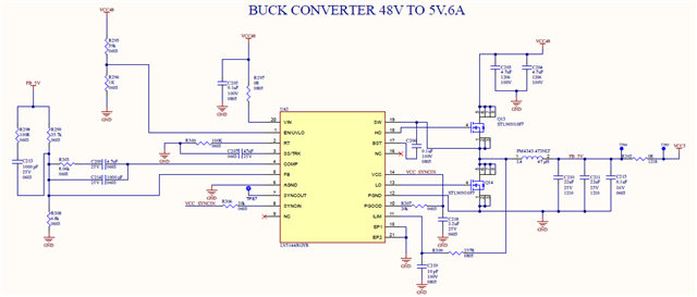

Hello TI team,
We are currently using the LV5144RGYR switching regulator for converting 48V to 5V. I reviewed the datasheet and found the operating current specification, but it appears to be under non-switching conditions. I would like to know the operating current during actual switching operation.
regards,
Loganathan. R
  • Hi Loganathan,
    Just add the VCC gate drive current (=Qg*Fsw for each FET) to the 2mA quiescent current spec. Take the Qg for each FET at the VCC level (7.5V).
    PS: we have converters that can do 6A (much easier implementation). Take a look at the LM70860 80V/6A converter for example
    Tim
