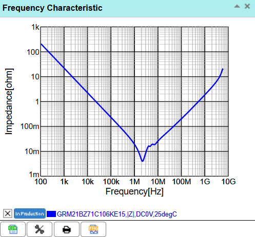

As an output capacitor I'm planing to use 10 uF/16 V capacitor made by Murata, with part number: GRM21BZ71C106KE15L. Should this capacitor work with legacy chip without any additional resistor (like 1 Ohm) added in series?

    The capacitor should definitely work for the new chip, however I am worried about it satisfying the ESR requirement of the legacy chip.
    When I inspect the impedance vs frequency curve for the P/N via Murata's SimSurf tool, it dips below the 200mΩ value (which wouldn't happen with 200mΩ ESR).
    Therefore I cannot guarantee it will remain stable with that output cap on the output over the entire recommended operating range.

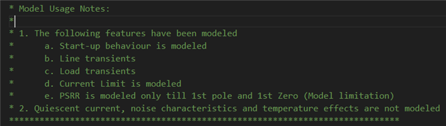

    The concern here is PSRR, especially if you're worried about how the parallel inductive load will affect output. The intrinsic noise is so low that it has to be placed inside a faraday cage to measure without being dominated by ambient EMI i.e. it's negligible when you have measurable input oscillation. Your best option to simulate is probably the public SPICE model. I took a look at the notes inside the SPICE model .lib file from TI.com, PSRR is modeled only by 1st pole and zero. Therefore it will be able to give an estimate of the magnitude of oscillation on the output, though not a perfectly accurate waveform.

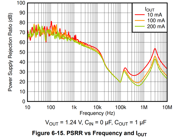

    Below is the measured PSRR from the datasheet, it's just an inverse of the transfer function from input to output (in fact we measure it using the BODE100's transfer function measurement with the input/output channels swapped). The take away is that, depending on the frequency of noise in the input, your output oscillation will be 10-1000x smaller.

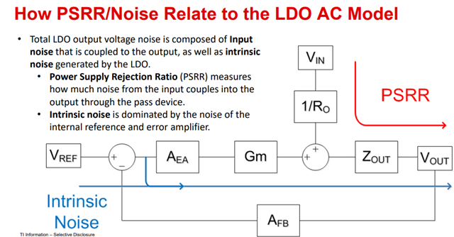

    The impact of the output circuit (feedback network, Cout/CFF, load) is a little bit more complicated but the basic concept is that the lower the impedance at that frequency, the more the feedback loop can reject it. That's why the trough's in the output capacitor's impedance vs frequency curve show up as peaks in the PSRR at >100kHz. If you look at the below image, you would be modifying Zout, Vout, and AFB.
