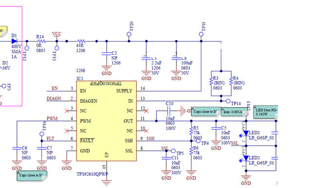

I am using TPS92610Q single channel IC for for TAIL LED function. when diagnostic detect single LED short or open, IC generate 2mA retry current which cause LEDs dimming with very low intensity.
How to resolve this retry current issue.

  • Hello Nicholas,
    Input to the device is pure dc signal 12V
    pls check below is my schematic.
    when i short or open the LED, devices tries to retry current 2mA and continuously blinking the non shorted or non open LED with very low intensity
    when there is failure in LED , my goal is to completely turn of LED, irrespective device shutdown or still working.
    this LED blinking should not be visible
  • Hello Tanvir,
    I have been testing different configurations of the circuit and may have found a solution using logic. I first tested by using a diode from FAULT to EN and DIAGEN to see if any of those would remove the retry current but was unable to stop the current from flowing. When FAULT was bridged to EN or DIAGEN it would pulse low for about 10 microseconds and then go high for 100 microseconds and pulse the full current across the LEDs.
    I do have a logic based solution for this device that enables the device when supply is applied to it and shuts off the device when FAULT pulls low.
    PSpice's transient simulations with a supply voltage ranging from 9V to 16V have worked for this circuit but I have not tested in real life. The SR latch is what holds the memory that a fault has happened. The Power on Reset circuit ensures that the SR latch's output to EN is high each time the power is cycled. The resistor divider connected from supply to FAULT to ensure the latch is properly configured and that the voltage applied to FAULT never goes above the recommended 7 volts. When FAULT pulses low, it is stored in the SR latch as long as the supply is applied to the circuit.
    This schematic will need to be tested with real parts to verify operation. A Schmitt-Trigger may need to be added between the Power On Reset circuit and the SR Latch to help with edge cases.
    If you have any questions, please let me know.
    Kind Regards,
    Nicholas Alexander
