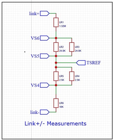

I’ve attached my resistor ladder schematic for reference. Any suggestions or clarifications would be appreciated.

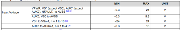

    Where to you see the requirement that Vcn > Vcn-1? The only requirements I see are those in the device electrical characteristics where the absolute maximum ratings are thusly:
    and the recommended operating conditions are:
    Provided that your Vcn pins are within these ranges there should be no damage to the device.

    Any voltages outside of the spec are not okay and could cause damage to the device. So, the reading of -4.115V is not acceptable.

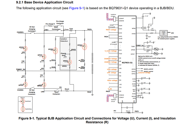

    You can find our guide to calculating LINK+/- in section 9.2.1.2.3 of the datasheet. The following sections also have information on the other measurements you are taking. However, LINK- is supposed to be similar to the ground voltage (near zero) and LINK+ is supposed to be near the total pack voltage. From the reading you have of VS4 (-4.115 V) and VS6 (-0.017) it seems like you have significant leakage current in your system or some other more pressing issue.
    This diagram in section 9.2.1 of the datasheet should give you a good idea on what the pins should be connected to:

  • Hi Bo,
    Can you please check if there are any mistakes in the schematic? For your information, I have used the same reference to design the PCB. Please find attachment of my schematics?Schematic_Bq79631-BJB-V1_2025-08-13.pdf

  • Mounish,
    If you measure the TSREF pin, what voltage do you see?

    I’ve noticed that when no external measurements are connected, TSREF reads 4.9V. However, its value keeps changing whenever input measurement voltages are applied.
    My concern is that since TSREF is supposed to act as a reference voltage, it should remain stable and not vary with the input. This makes me think something might be wrong.
