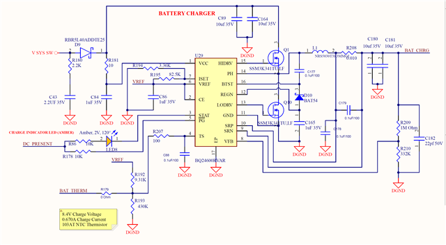

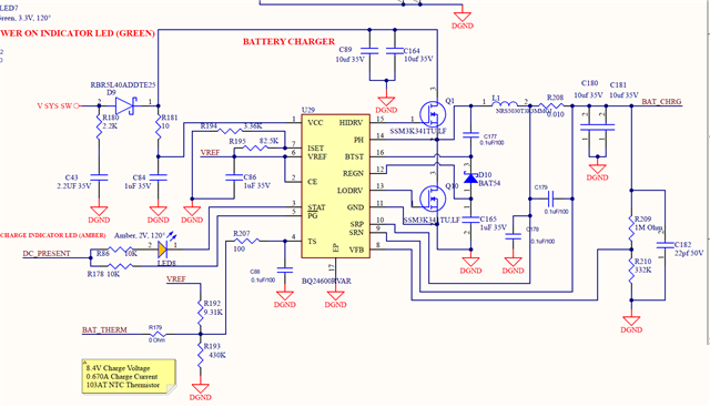

Can you upload another image of the schematic?, it's not very clear.

I've also attached a clearer picture of the schematic. We expect the battery to charge up to 8.4V at 0.67 A, but have not seen it go above the 0.125A precharge current if anything.

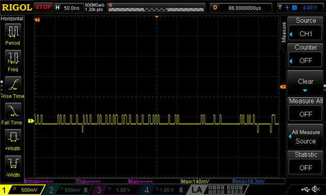

Additionally, here are some scope captures of the high drive(first photo) and low drive(second photo) signals incase it may be useful:
