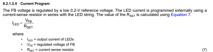

    Seems the issue is the NHD TFT display we are using has the backlight LEDs in parallel.  Vf for those LEDs is 2.8 to 3.4V.  Consequently, the 5V supply on the TPS61165 never begins to regulate, instead, Rsense at 33 ohms limits the current to around (5-3)/33 = 60mA or so.

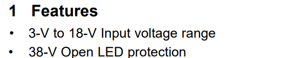

    Next question, would dropping 5V to 3V and using the TPS61166 here work to regulate to 100mA for LEDs as well as allow it to turn off at 0 percent DC on a PWM?
    Tim
  • Hi Tim,
    The current depends on below equation:
    Please make sure the input power is stable.
    Second question; TPS61166 can support 3V working.
    Colin
