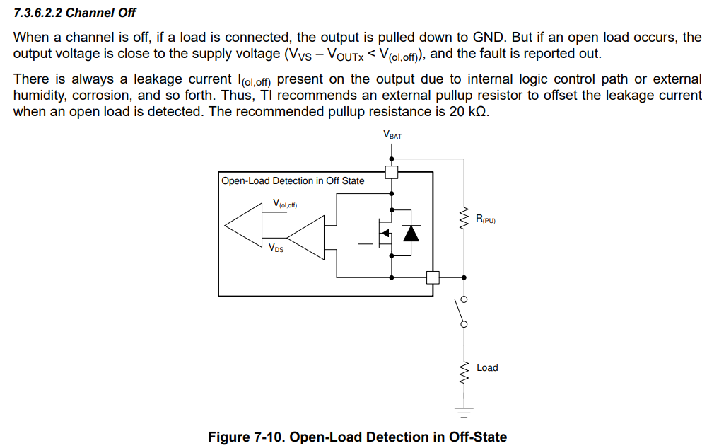

Hello Support,
I am planning to use TPS4H160A-Q1. What is the minimum load that is required disable open load fault?
Sadiq

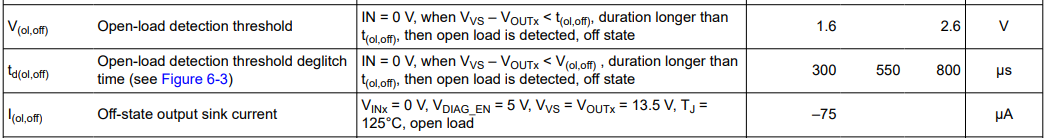

Hi Sadiq,
An Open load fault is cleared when (Vvs -Vout > V(ol,off)):
so you would need the voltage difference between Vin and Vout to be greater than 2.6V
however as their is only a pullup on VOUT you only need a resistance that pulls down more than R Pull Up
Nicholas Petersilge
If you add a pull down resistor at the output than there is always a path to ground. ( no open load condition). This equation (Vvs -Vout > V(ol,off) is true
Why we need pull up in this case?
Hi Sadiq,
Open load detection is a feature of the device to determine if there isn't a load.
The device always had a leakage current so in order for the device to determine if their is an open load it needs a pull up resistor between VS and VOUT
