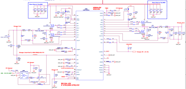

We use LM5143 for charger to Battery.My application as below:
32V input,18V to 25V output,single output,two-phase synchronous buck.We want to output 11Amps.
1 - Can this be achieved?
2 - How to calculate mos power dissipation,is there any apllication note?
3 - How to do thermal design?
Our schematic as below:
