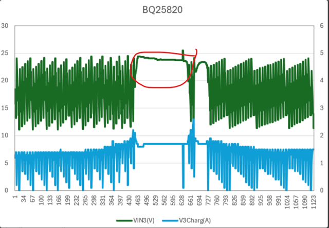

Hi, we are trying to understand the MPPT capability of the BQ25820. Attach is the data we got with a 24V Solar Panel.
The result seems to be having no MPPT.
What should be done to improve it?
MPPT has been Enable with 3mins timer.

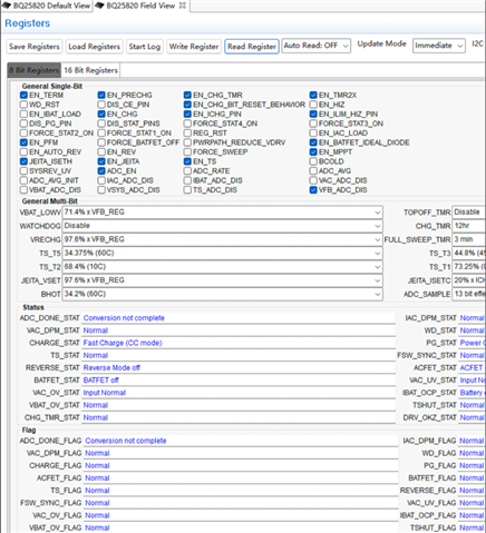

  • Hi Christian,
    Thanks for the response. See register as per attach.
    BRegards,
    Chris

  • Hello Christoperson,
    Your register data indicates the MPPT operation is working. What exactly is happening that makes you think it is not? I'm not really sure what is happening in the graph you provided.

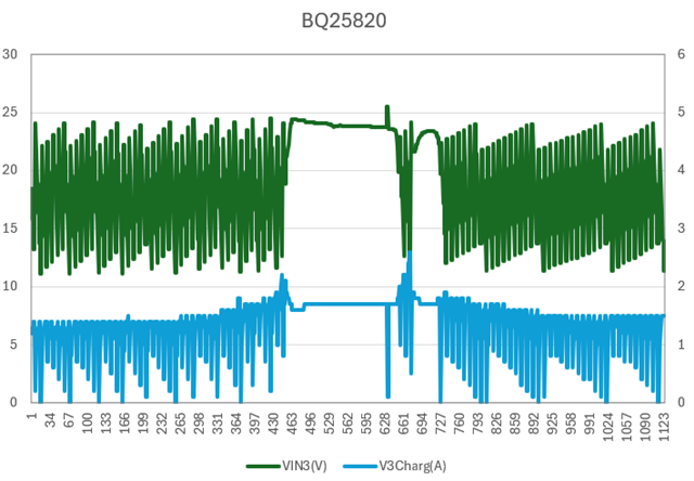

  • Hi Christian,
    As per the graph, the solar panel tends to drop (start and end section). Only in the middle section that it is stable.
    The weather becomes cloudy when the solar panel tends to drop.
    Any setting (IC or the components around) we can adjust to prevent this?
    Chris

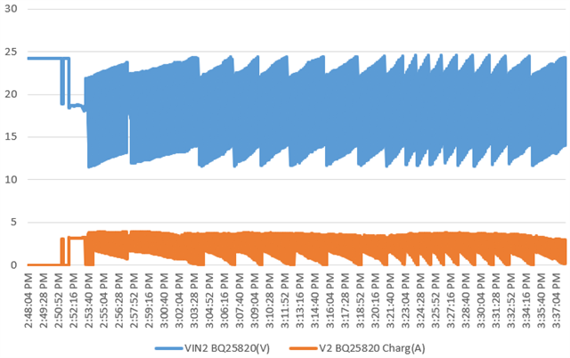

    What is the time scale?
    Christian.
  • Hi Christian,
    Is around 3mins. See attach exported file.
    BQ25820 Result.xlsx
    I think this corresponds with your set 3mins timer, after it finds the MPPT voltage it should start looking again after 3mins. Do still see this behavior if MPPT is disable? When this behavior occurs is it activactly looking for MMPT setpoint?
    How to identify that it is actively looking for MPPT setpoint?
    The BQ25820 should have a MPPT_STAT bit REG0x22[1:0]. However, there was a typo in the datasheet, that marked this bit as reserved, which led this to be left out for the BQ25820 GUI. However, it can be accessed using the BQ25750 GUI, or look at bits 1/0 in BQ25820 gui.
    Do you recommend a longer or shorter timer?
    If you don't want it seraching as often, I wold recommend a longer time.
    Christian.
  • Hi Christian,
    We did some test by changing the search time to 20mins.
    But we do see same waveform the voltage and current are oscillating.
    Is there a way to prevent this or is this normal? What do you think is happening here.

  • Hi Christian,
    Yes, there is improvement in the frequency of the occurrence of the oscillating voltage and current.

    Can you try increasing your VAC_DPM REG0x08, to the minimum value that you want the solar panel input to drop to? For example 20V.
    Christian.
