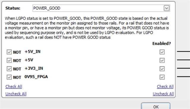

UCD90160A: Powergood status to control Logic controlled outputs
Part Number: UCD90160A
Hello All,
I am trying to set the configuration for the logic controlled GPOS. On one side of the logic gate i have 3 GPI signals and on the other side of the logic i have selected all the power goods and using OR logic want the output to drive low if any of the power goods status become unhappy. Is it possible to see the status of these in real time as currently during testing i lower the voltage but it does not drive the output.
Please see screenshots of the configuration below:
Any help would be great,
Jack
