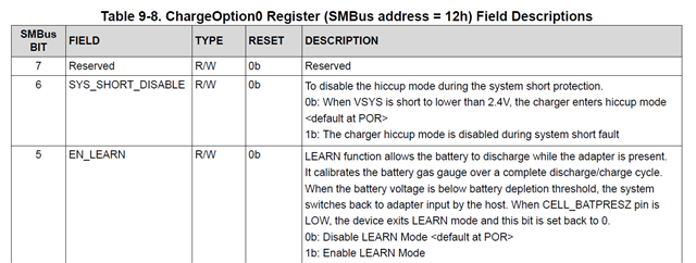

Hi Team,
From datasheet, I can find below description for learn mode. Beside that, is there any more detailed introduction material for learn mode?
When the device is in learn mode, 4 switching MOSFETs are not switching(VBUS to VSYS is Hi-Z, VSYS is not regulated), BATFET is totally ON, correct?
