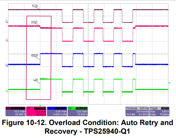

    The response time for normal OCP is usually few ms. We don't have it in the datasheet for this device but this can be evaluated by customer. The response time for SCP is given in the datasheet (200ns)
    This waveform is showing OCP response and then TSD during OCP and then auto-retry.

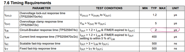

  • Hi Alberto,
    Let me clarify this with an example.
    this is from TPS25947 datasheet. If you see the response time is 2us for that device. I had discussion with design team, and we expect ~4-5us response time. This is time for device to detect Overcurrent and perform OCP.
    For TPS25947, we also have another entry with current limit settling time (400us). We can expect similar time if customer wants to know time in which current will settle to ILIM value.
    I hope this clarifies this. It looks like in first reply I made a typing error. I wanted to write microseconds (for the response time).
