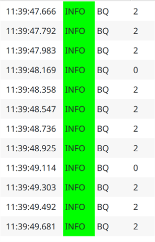

Interestingly, when reading back CB_ACTIVE_CELLS at the same 5x/sec interval, I notice the following:
Something internal to the BQ76952 is CLEARING the register every second on the dot.  According to SLUUBY2B, table 6-9, there are a lot of internal functions that run at a 1-second interval, including "cell balancing"--but this appears to be for automatic cell balancing.  I did notice in https://github.com/LibreSolar/bms-firmware/blob/77c6206b92399028af6a5ca893afecc87236ee7f/drivers/bms_ic/bq769x2/bq769x2.c#L395-L401 that if auto balancing was disabled, they would set "Balance Config" [reg 0x9335] to 0x00.  I tried that--and it did not do anything.
It appears that something is causing the BQ76952 to shut off cell balancing in the 1-second internal loop before actually gating the request to the AFE--but all of the alarm and fail flags are clear.
If the BQ76952 is not reporting any alarms or fails, then why is it refusing to enabling balancing when requested by the host via the CB_ACTIVE_CELLS subcommand?  I've lost several entire days on this singular problem alone...and it stopped being funny a while ago.

  • I knew it had to be something stupid....and it was.
    BQ76952 configuration defaults set TS1 to a cell thermistor input on powerup.
    Well, I didn't have a thermistor connected to TS1.
    Disabled TS1 via TS1_CONFIG, enabled internal temp for cell temperature (DA_CONFIG), and *poof* host-controlled cell balancing works perfectly.

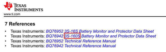

  • Also, another errata for SLUAA11B, page 21:
    BQ76942 does not handle 160S.  It's a 3-10S AFE.
