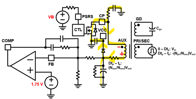

In the related thread (original question), I have questioned whether " actively cancelling (through the use of CP output) the leading-edge voltage overshoot (causing the feedback capacitor to peak-charge)" can be truly postulated. Because the body diode conducts immediately as soon as the primary Mosfet is switched off and the leakage inductance spike is thus exposed to the feedback capacitor. But there is a sort of corollary: only if there would be a small delay of the CP-Mosfet being switched on, until that, the nominal winding voltage does not inject current to the capacitor because in the previous cycle the capacitor is charged with the winding voltage during primary switch off-state minus the minimal voltage drop over the "ideal diode" behind the CP terminal. On the start of the next cycle, only the body diode conducts and because the capacitor has not dropped the voltage more than a few mV, the net voltage "available" to the capacitor is lower: winding voltage minus body diode. So in this minimal time interval, the leakage inductance spike may inject some current (limited by the series resistor), but it has no effect. And hence the capacitor voltage is quite accurately sensing the net winding voltage.
But according to my experiments, it seems that any delay at all is hardly detectable. Perhaps any TI-employee could give a specification of it. Of course, a delay should be longer than the spike width in order to obtain best load regulation.
The explanation above could also help in getting a good load regulation also if an ideal diode circuit on the secondary is used as rectifier. The output voltage is (ideally) based on the regulation of the secondary winding voltage when the Mosfet of the ideal diode circuit conducts. But during an initial delay (of say 40 ns) before the Mosfet is switched off, the secondary winding voltage is then approx. 0.6V higher. This would be reflected in the aux (and the primary) winding. And that would well increase the feedback capacitor voltage (effectively lowering the output voltage). But if the CP-Mosfet would also have a delay of no less than the secondary side delay, this effect would actually be neutralized.
So even more it is interesting to know the CP-Mosfet on-delay.

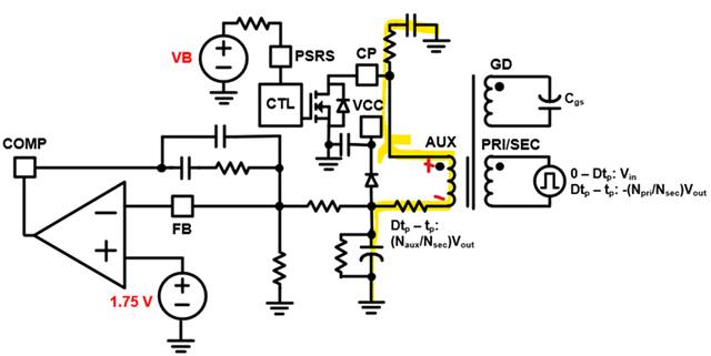

Next question: could a timed control signal applied to PSRS force an extra CP-Mosfet delay? And even a premature stop of CP Mosfet conducting when the voltage on PSRS is set to low? In short: a signal that follows the CP-voltage, with offset shift towards the positive voltage range and a delay onto the positive slope on PSRS. To say it simple: can PSRS be "modulated" by a digital signal or would a built in flip-flop behind PSRS make a continuous digital control impossible?
  • Hi Rob,
    Thanks for reaching out.
    Normally a flyback + PSR + diode rectification (including ideal diode case) combination does not have a good load regulation. Since the Vout sampling signal is based on AUX winding not the Vout directly. Changing to SSR will solve the major issue of load regulation. But if keeping PSE, changing diode rectification to sync FET will improve the load regulation too, but not as significant as SSR.
    For your concerns of transient ripples, when primary FET is off (D x t_p to t_p), current can flow out from CP pin either from its FET's channel or body diode. Vout sampling cap will be charged at this time. Inrush by leakage/stary inductance can be absorbed by VCC cap and RC snubber.
    When primary FET is on (0 to D x t_p), CP pin has a positive voltage bias, inrush by leakage/stary inductance can be absorbed by RC snubber.

  • Thanks for your answer, Diang. However that adds no new information for me. Please answer whether the PSRS pin may be sourced by a digital level square wave in order to exactly limit the time interval that the CP-Mosfet is conducting. I don't guess that I'm going to implement such, but at this time I also cannot exclude this. Because of TI's exact knowledge of the internal circuit, an answer to this question can be given, at any case by the design engineering section.
    The same applies to the delay in ns of CP gate drive on after the main MOSfet gate has switched off. It should be possible to specify this.

    Sorry that some of design information is nondisclosure. From application aspect, we provided the design recommend: to make CP works properly in flyback, PSRS open for sync FET, PSRS short to RTN for other cases. Ideal diode is not the same with sync FET as we already discussed.
    Could you share the full PoE + DC/DC circuit schematic so we can check the details?

  • What I ask has nothing to do with design information, but with behaviour. Which could simply be measured (CP-Mosfet ON-delay) and verified (modulation via PSRS) by setting up an appropriate test-setup.
    Note: Ideal diode tests are - of course - only executed with PSRS to RTN.

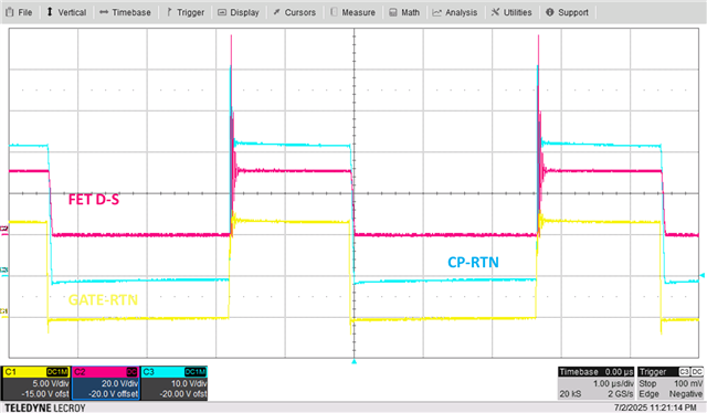

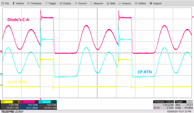

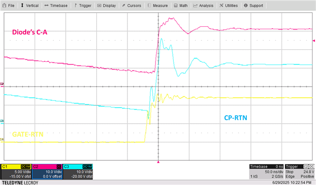

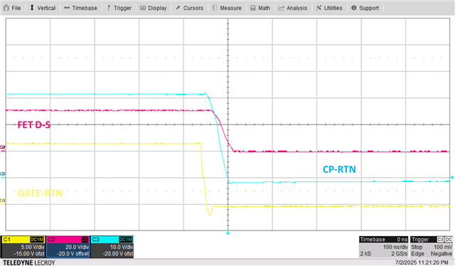

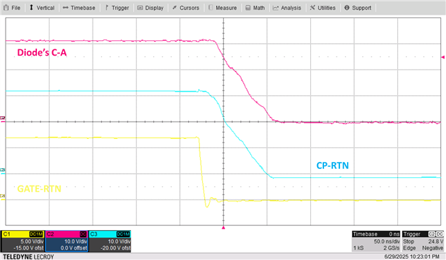

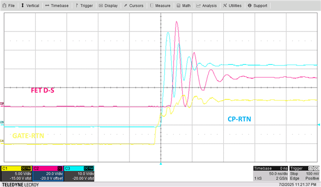

  • Hi Rob,
    Hope below waveform behavior can help.
    Diang
  • Thanks for presenting these oscillograms, assumed to have been recorded using the EVM as is, where PSRS is tied to RTN. I guess that "Diode's C-A" means secondary side diode, in the assumed case the secondary side mosfet exhibiting no delay except slew. Since the blue line does not  go below the trace reference (sec. GND), the mosfet seems immediately on because no short diode conduction time is visible (as would be the case by using UCC26412). Using a lower V/div. setting, one would presumably see a small negative voltage.
    Contrary, the CP to RTN clearly has a negative voltage of approx. -1V which shows that the CP-Mosfet is not switched on (due to PSRS tied to RTN). Of course no switching delay is visible. In the case of PSRS open, one could  see a short time that approx. -1V is seen, followed by - let's say - 0.1 V because of Mosfet on. But in practice, I see no such delay. That also means that the leakage inductance spike is by no means absorbed by "a unique approach which basically consists in actively cancelling (through the use of CP output) the leading-edge voltage overshoot" (datasheet 8.3.6.3). This is why you need a small resistor between the aux winding and the 3.3uF feedback capacitor. An oscillogram of the voltage on the winding side of this resistor should show this (could you supply this? I don't have the EVM). Despite this, regulation can work in a reasonably good way, because in CCM, the spike energy increases less with increasing power in CCM than in DCM mode.
    I think it's up to you to prove whether the quoted statement from the datasheet is correct or not.
    Edit: with PSRS tied to RTN on EVM with any else unchanged, I'd expect a higher output voltage, since the voltage on the feedback capacitor is regulated (fixed voltage), while the amplitude of the aux winding is increased by the difference of CP-Mosfet drain-source voltage in conduction state and its mere body diode voltage. This increase is reflected on the output winding.

  • Hi Rob,
    Thanks for your patience. I think we could merge our discussion on another similar thread.
    The waveform is captured by TI's reference board. This board has shorted PSRS to RTN (you can also use schottky at RTN to replace CP's FET in this case when no PSR sync FET).
    Also please check this case when PSRS is open. I saw the CP is closer to RTN but not too much, may be the CP FET is high on-resistance.
    Diang

    It looks that you're applying approx. 20V input voltage and hence, use the separate DC input. It would be interesting to execute the same measurement also when PSRS is left open as is originally the case on the EVM. Supposed there is some delay between Drain from 0 to positive voltage  and CP Mosfet on. In that case, the negative voltage would then measure approx. -1 V, because only the body diode would conduct. Supposed then that the CP on delay would be 100 ns, then this -1 V could be seen for that time, and than immediately get close to 0V, as outlined in my previous posting entry. Then, part of the leakage induction spike would indeed be compensated as stated in the datasheet.
    BTW: the very high spike you measure, followed by ringing, is apparently due to applying a scope probe with the standard GND wire instead of using the GND ring close to the probe tip, that facilitates the shortest possible GND route.
    EDIT - corollary: Because of the facts that the output voltage is quite constant over time and this also applies to the voltage of the (for an aux supply relative) big - 3,3µF - voltage over the Feedback capacitor, the picture is a bit more complex, since then the voltage over the winding (during on-state for aux and output) is also constant. Consequently, the negative voltage could NOT reach -1V in the first (assumed) 100 ns after the primary Mosfet is switched off. During this small time interval, the auxiliary winding current would be approx. zero. So, I think that a better way to know if there is a CP on delay is to measure the current through the resistor between Aux winding and feedback capacitor! But the presence of a spike may well be visible as a short negative excursion in the case CP is just in off state because of a minor delay of its internal gate control. Such a negative spike related excursion would inherently limit the injection into the feedback capacitor.
    EDIT 2 (afterwards I get aware that the oscillograms above were done on the PMP22806 reference design with secondary simple diode rectification). Therefore I put some strikethrough formatting above.
