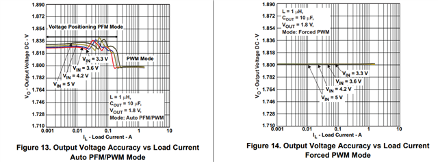

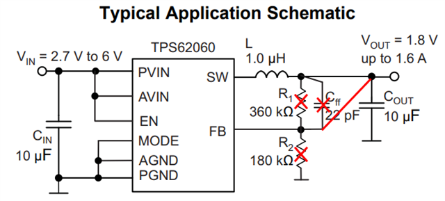

Customer has a few boards using the TPS62063DSGR chip, which is essentially a fixed 3.3V regulator. I am trying to find some information on the datasheet, but it looks like the datasheet is catered towards the adjustable output version of the chip. Do you know if there is any application example for this chip? I am also wondering what the tolerance of the output voltage would be. Their load is fairly small ~450mA.

    For the fixed VOUT versions, the FB network has to be disconnected and the FB should be directly connected to VOUT.
    The output voltage accuracy of the fixed will be same as adjustable. You refer to the following figures in datasheet for VOUT vs load current.
