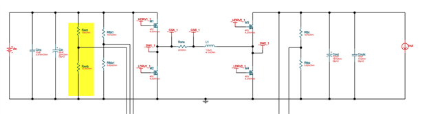

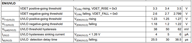

I used webench to refer to the circuit diagram. The EN/UVLO voltage divider resistor values came out to be Rent = 75 kohm / Renb = 348 ohms.
This doesn't seem correct to me. The datasheet says Renb = 12.4 kohm.
If Renb = 348 ohms is correct, please explain why.
WBDesign234.pdf

    2. There are different approaches used for min voltage to turn on and off and hysteresis
    You can also use the Quickstart calcualor - this allows you more control. Here the min voltages are used to ensure the controller is turned on.

    Regarding (2)
    When Renb = 348Ω, it seems that the EN Vth cannot be exceeded and therefore the device will not start. Am I misunderstanding this?

  • Hi Ishiwata,
    2, this depends on VIN and Rent
    3, I think Webench does not provide the option to not use VBIAS

  • Hi Stefan,
    Thank you for your answer.
    Please explain (2) again.
    In the Webench circuit diagram below, the input voltage to EN_UVLO is 0.11V when VIN=24V.
    I don't think this reaches the EN threshold voltage, but am I understanding this incorrectly?
    Ishiwata
  • Hi Ishiwata,
    it looks like the Webench tool has an issue here.
    I will check with with the Team responsible for Webench but the update might take some time.
    Please use the Quickstart calculator meanwhile. As mentioned it allows much more control on the circuit.

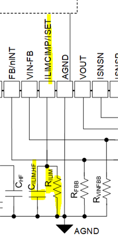

    (5) I have a question about setting the ILIMCOMP/ISET pins.
    For loads such as LEDs, should I refer to equations (23), (24), and (25) for CC-mode or CR-mode on page 42 of the datasheet?
    Or would the calculation results from LM51772_Buck-Boost_Quickstart_Tool_V1_2_0.xlsm be acceptable?

    We have fixed UVLO resistor on WEBENCH, we are getting below combination of resistor for UVLO. These updates will be available on ti.com by next WEBENCH release. tentatively by 26th Aug

    5. Please separate ISET = fixed current limit and ILIM = current limit set via DAC
    Best option is to have the footprint for the additional components on the PCB - if you system would require the additional filtering the components could be easily added. For a LED the simple filter should be OK as this does not have a very high dynamic load change.
    6. For ISET it is recommended to have a small cap in parallel to the R to filter out HF noise.  For simplicity this is not shown in the figure in the datasheet.

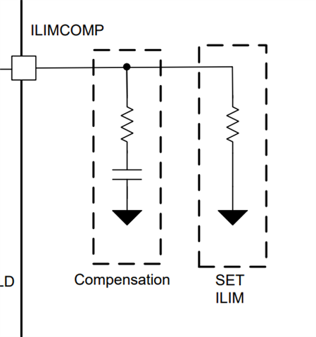

    (9) Regarding the ILIMCOMP/ISET pins
    The circuit I'm considering is planned to be configured via a DAC.
    Would it be better to connect the RC series resistor in the Compensation box in the diagram below to the ILIMCOMP pin?
    In the LM51772 Buck-Boost Quickstart tool V1_2, when configuring via a DAC, only C is shown as directly connected, as shown below. Is this okay?

    9, for a simple filter a C is enough. If a more complex filter, e.g. for better responding to dynamic load, is required an filter like on the COMP pin could be used ( R + C  ||  C).  I recommend to place the footprint for the complex filter, then you can choose the assembly option without layout change.
