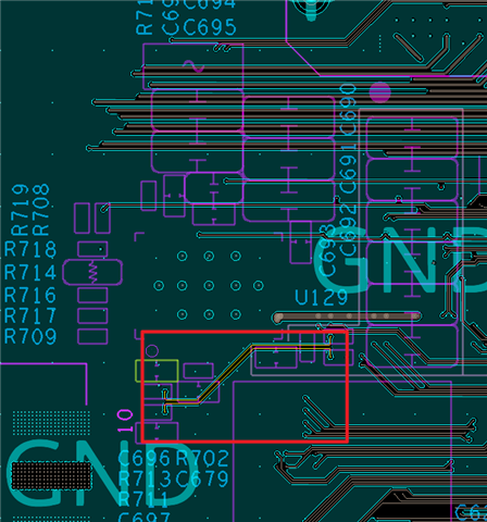

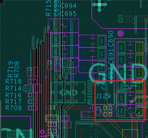

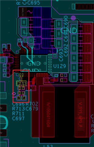

  TOP : RSP, RSN
  Regarding R713 and R711 Wiring on Inner Layers
 Regarding R710, R712, and VOUT Cap Connections

  • I would like to confirm the following points regarding the recent recommendation to remove C697 and R709 in order to adjust the PGOOD threshold:
    1. If C697 and R709 are simply marked as DNP on the schematic, is it sufficient for verification purposes, or would additional modifications be required?
    2. When RAMP is left OPEN, does this correspond to tying it to AGND internally?
    3. For the RSP/RSN routing, is it acceptable not to design them as 100 Ω differential impedance (Outer layer: 0.08 / 0.145 mm, Inner layer: 0.04 / 0.12 mm)?
    4. Would it be better practice to design the RSP/RSN traces with a width of 0.25 mm instead?
    I would appreciate your confirmation on the above points.
    Yes, it is acceptable NOT to design the RSP/RSN feedback network as a 100Ω differential impedance pair.  While the pair should be routed as a differential to minimize differential noise coupling, it does not need to be a specific controlled impedance.
    0.25mm (10mil) or 0.5mm (20mil) are commonly used remote sense trace widths.
