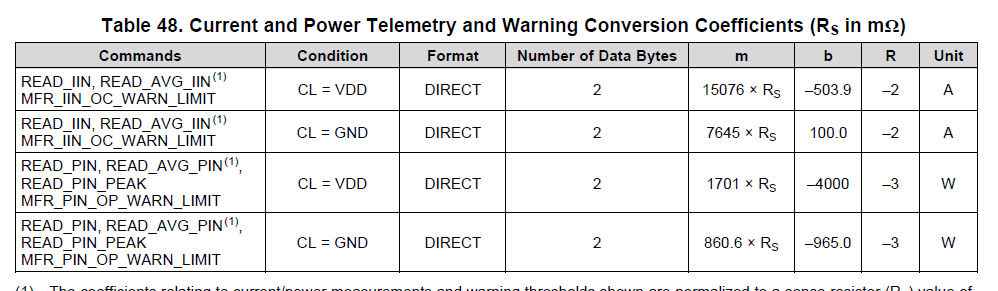

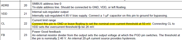

In the hardware circuit, the CL pin is floating, so according to the datasheet, CL = 50 mV. When CL=GND, READ_IIN => m=7645 * Rs; b=100.0; R=-2.

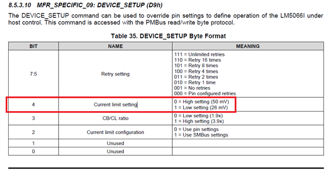

I would like to ask, what should Register DEVICE_SETUP (0xD9) be set to? Should bit4 be set to 0?

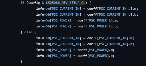

However, in the OpenBMC drivers/hwmon/pmbus/lm25066.c, when LM25066_DEV_SETUP_CL = 0 (bit4 Current Limit Setting), it uses the PSC_CURRENT_IN value.

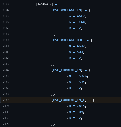

From the lm5066i array, PSC_CURRENT_IN has m=15076; b=-504; R=-2, but this is inconsistent with what's shown in the datasheet. Instead, setting Register DEVICE_SETUP bit4 to 1 (26 mV) and using PSC_CURRENT_IN_L parameters would be consistent with the datasheet.
So I'd like to ask what Register DEVICE_SETUP (0xD9) should be set to? Why is the driver code inconsistent with the datasheet? Is there something wrong with my understanding? Please help explain.
    Default value in D9h register is 0000h. If the bit 2 in D9h register is set to 0, writing 0 or 1 in D9h register is immaterial. As you are using the current limit setting as per the pin configuration, D9h should be written as 0000h.

    CL pin definitions are different in LM5066i and LM25066.
