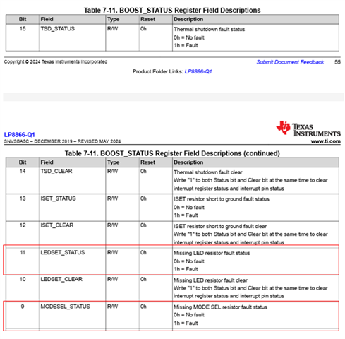

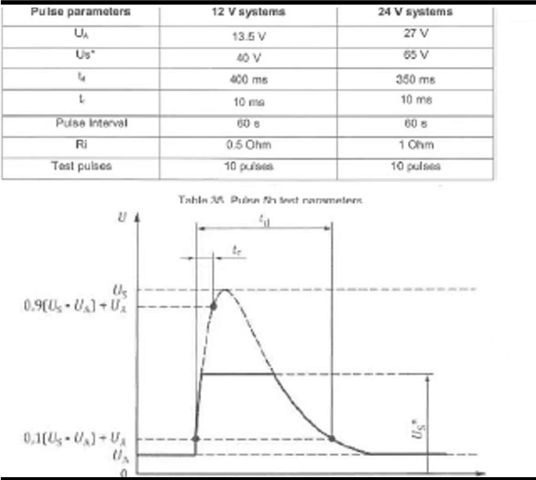

When the VIN input signal is as follows, flickering is observed when the voltage is maintained at 40V for 400ms. What could be the cause?
Current output setting:
OVPH: 30V
OVPL: 27V
