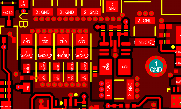

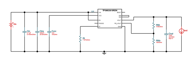

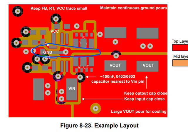

Here is the recommended schematic for this part outputting 12V
This is what I have R23 is changed to 110K
I'm stepping down form 22V to 12V
My issue is when, I load the DC DC converter with more than 500mA the voltage starts to be pulled down.
Circuit works below 500mA, I need to be operational at least 1A.
My understanding is thtat this is a 1.5A current handling
Please advise what could I be missing?
