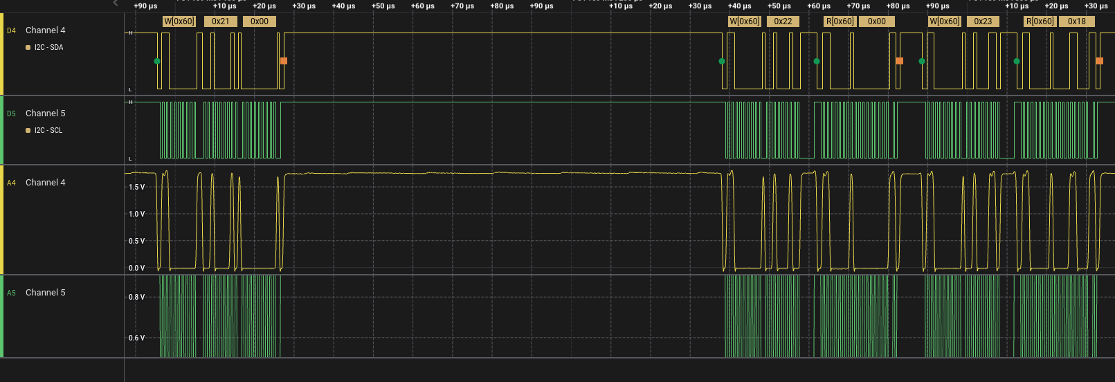

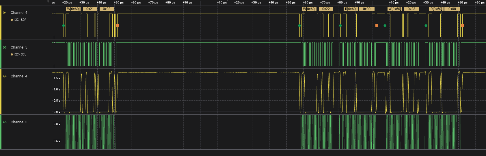

    I've also attached saleae captures of my measurement transactions for BUCK0, BUCK2, BUCK3
    BUCK0
    BUCK2
    BUCK3
  • Hi Rene,
    Thanks for the info!
    Are you able to check the status of the I_LOAD_READY bit (bit 0 of register 0x18) ?
    I believe you can also monitor the nINT status, and an interrupt will be generated when the load current measurement is ready.
