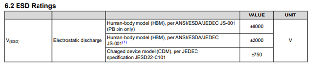

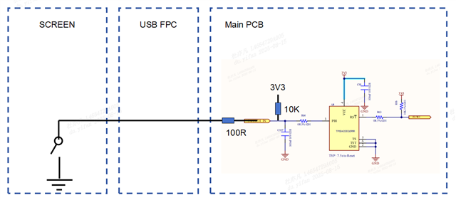

Customer test to find 2/1000 TPS3422 failed during whole machine test under 4&8kV test.
Test to find the SWITCH_IN voltage is 2V8 and there is no RST signal after pressing RESET button.
Support need:
Can you help to check what may cause it and any suggestion to improve the protection ability? Thanks!
