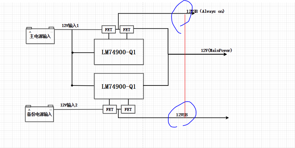

LM74900-Q1: Can two chips always on output be directly connected together
Part Number: LM74900-Q1
We are evaluating the use of LM74900-Q1 as a redundant power supply. The connection diagram is shown below. We would like to know if the always on outputs of these two chips can be directly connected together and if there is any risk involved. Thank you
