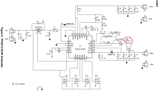

If we want to calculate the value of R6 in the circuit shown in the attached image, can we find a formula, or is this value determined entirely by trial between 10 kΩ and 100 kΩ?

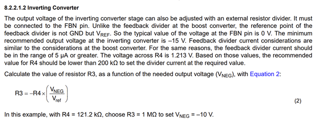

Hi Behiye,
Please see below decription in datasheet page 13:
Colin
