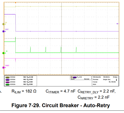

    Not completely correct. The device will go into current limiting. The output will be equal to ILIM*R_load. PG signal is controlled using that PGTH comparator. That is completely independent from the actual control logic block.
    I am adding an example waveform for similar conditions. Also, if the load is high during the soft short, the startup themself can fail due to higher power dissipation (thermal shutdown) providing even shorter glitches.
    Therefore the datasheet statement “Adjustable overcurrent protection (with adjustable blanking timer) - Circuit Breaker to protect against soft overload conditions” is misleading because the circuit breaker functionality does not remain active during persistent soft-shorts and the TPS25980 current limits instead. The circuit breaker only appears to operate effectively when the soft-short condition is transient and clears after the first retry.
    The circuit breaker response is present in steady state. The device will only perform current limited startup during retry so more of a recovery attempt (which can result to some duration of current limiting for the system) but this does not change the fact that during primary protection event it will limit the current.  I understand that your concern is circuit breaker should never limit and should immediately fail the startup is current is higher than the set current limit.
