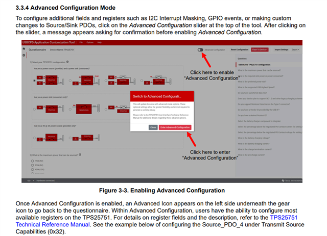

For Sink-only, the choices for requested voltages are 5, 9, 15, and 20.
The power source advertises 12V as one of it's source capabilities.
How can I have TPS25751D request 12V instead?
  • Hi Bill,
    Thank you for reaching out!
    See Section 3.34 in the TPS25751EVM User Guide on how to enable Advanced Configuration Mode in the GUI Tool to set the Sink Capabilities Register to desired voltage/current levels.

  • Thanks for the tip.
    I found the voltage selected in the questionnaire in SINK PDO_3 of the TX SINK CAPABILITIES (0X33) register.
    The other two PDO's there were for 5V and 9V.
    Are those fallbacks to use if the source doesn't provide the voltage you want?

  • Hi Bill,
    Your understanding is correct. The Sink will Request a PDO from the Source's advertised capabilities. Typically, the Sink will Request its maximum capability if the Source can offer it. A 5V Sink PDO is required per PD specification for the Type-C implicit contract. A 9V PDO is optional.
