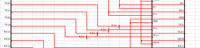

  • Hi Shinichi,
    Are you intending to route the HD3SS3220 as a DFP, UFP, or DRP? It looks like a DFP might be intended, however it is currently configured as a DRP. The port pin should be pulled-up for a DFP configuration.
    For a DFP connection, the ID pin needs to be pulled up to VDD with a 200KOhm resistor. Additionally, the ID pin needs to be used to control VBUS through a VBUS switch. VBUS being sent through the type-C connector is part of the CC negotiation process, and should only be sent when ID is pulled low. I would recommend adding a power switch that is enabled when the EN pin pulled low, and attached to the ID pin.
    Are you intending this for a passthrough application, I.E The signal coming in from the type-B port goes out the TX of the type-C port, and vice-versa? Or will the board you are developing have a controller interfacing with the TX/RX of these ports?
    If you intend to use the HD3SS3220 as a pass-through, then the RX of the type-B port should connect to the TXp/n of the HD3SS3220, and the TX of the type-B port should connect to the RXP/N of the HD3SS3220. That way, the signal coming in from the type-B port from the RX pins is routed to the TX of the type-C connector, and vice-versa.
    If acting as a passthrough, these caps on the TX lanes should not be needed, as the TX signal should already be coupled at the host/CPU.
    For a DFP application, the VBUS_DET pin can be left floating, it is not required.
    The CURRENT_MODE pin should be either pulled-up or pulled-down, according to the amount of current you want to advertise:
    Correctly, if the polarities of the lanes are swapped there should be no issue. Compliant USB3 Phy's should support polarity inversion.
    Please let me know if you have any other questions.
    Ryan

    Our developing board, there is not controller.
    VBUS comes from CPU board with USB3.0 Type-B connector and passthrough the USB3.0 Type-C  output.
    → p28 is indeed pulled up to VBUS with 200kΩ.
    Our board does not have a control circuit, and ID pin is output .
    Since there is nothing to connect to, it is unclear why it is pulled up to VBUS with 200kΩ.
    Even in this case, is it necessary to pull it up with 200kΩ?
    Is it to prevent the terminal from becoming unstable when set to Hi-Z because it is an open-drain output terminal?
    I thought that Type B TX+ would connect to Type C TX1+ and TX2+, and that the HD3SS3220 would just switch between TX1+ and TX2.
     Is it correct to connect Type B TX+ to Type C RX1+ and RX2+?
    Could you please explain for more detail.

  • Hi Shinichi,
    On the revised schematic, it still looks like the ID pin is floating. This pin is an open-drain, so it needs to be connected to something like VDD5 or VCC3 with a 200Kohm resistor. Additionally, there needs to be a power switch on the board which is controlling VBUS.
    The ID pin is used to control when VBUS is sent to the type-C connector, in this case from the type-B port. This can be done by implementing a power switch, and routing the ID pin to the EN pin of that power switch. Then, once there is a connection, the ID pin will be pulled low, which should indicate for the switch to enable sending VBUS to the type- Connector.
    If ID is not used to control when VBUS goes to the type-C connector, then that will cause issues with the CC negotiation, resulting in either only one side working, or no USB3 connection working. I would recommend looking at our 3220DFP-DGLEVM for an example of what this application should look like.
    The Type B TX+/- is actively send a signal OUT of the type-B connector, and the same goes for the TX1/2 +/- pins of the type-C connector, where these pins are actively sending a signal OUT of the type-C connector. If you route these two lines together, there will be no signals moving through the device.
    As such, you should route the RX of the type-B connector, which receives signal from the type-B cable, to the TX of the type-C connector, which will transmit this signal through the type-C cable. And you should route the RX of the type-C connector to the TX of the type-B connector.
    In this case, SSTX of the HD3SS3220 would route to the RX of the type-B connector, while the SSRX of the HD3SS3220 would route to the TX of the type-B connector. Then, you would route the TX1/2 pins of the HD3SS3220 to the TX pins of the type-C connector, and the RX1/2 pins to the RX pins of the type-C connector.
    That way, the signal received by the type-B port is transmitted out the type-C port, and the signal received by the type-C port is transmitted out the type-B port. You want this board to essentially act as a passthrough for these signals.

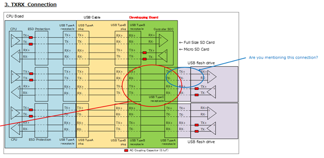

    1. Can the attached schematic achieve DFP pass-through between a Type-B receptacle and a Type-C receptacle?
    2. In the attached schematic, the HD3SS3220 acts as a DFP, and will the HD3SS3220's CC pin be pulled up with 56kΩ?
    (DFP Default USB Power)
    3.
    In our case, a Type-C USB memory stick is connected to the Type-C receptacle, not a Type-C cable.
    Please refer to the system configuration diagram at the top of the updated document.
    Would the answer be the same in this case?
    Please let me know if there are any difference in the answers.
    This connects the TX of the Type-B to the RX of the Type-C (cross connection).
    However, for the 3220DFP-DGLEVM,
    Wire the SSTX of the HD3SS3220 to the RX of the Type-A connector, and wire the SSRX of the HD3SS3220 to the TX of the Type-A connector.
    Next, wire the TX1/2 pins of the HD3SS3220 to the RX pin of the Type-C connector, and the RX1/2 pins of the HD3SS3220 to the TX pin of the Type-C connector
    .For the 3220DFP-DGLEVM, the Type A TX connects to the Type C TX (straight connection). This differs from your answer (cross connection).
    Is the reason for this difference because, in my case, I have a cross cable with a Type A plug and a Type B plug between the board on which the HD3SS3220 is installed and the CPU board? (Please refer to the attached system configuration diagram at the top.)
    Please explain the reason.

  • Hi Shinichi,
    Please ensure the VBUS being supplied to the type-C controller is the VBUS being output by the TPS25910. Otherwise, it looks like it should be setup correctly, yes.
    There should be no need to externally pull-up the CC pins. CC controllers on both sides of the type-C connection should be able to handle the pull-up and pull-downs on the CC lanes as needed.
    Yes, it would still be the same in terms of routing. The TX of the connector will connect to the RX of the memory stick, and vice-versa.
    This is primarily because of the type-A plug that's on this EVM, as opposed to the type-B receptacle you are using on this board. In this case, the UFP EVM would be most similar to how you should route the TX and RX signals through the HD3SS3220. Right now in the schematic though, it looks like you have it configured correctly.

    We want to ensure that the HD3SS3220 is the DFP even when a smartphone is connected to our device.
    This is to prevent VBUS conflicts.
    Where in the attached circuit diagram do the TX of the connector and RX of the memory stick you mentioned refer to?
    (I would understand if you were referring to the TX of the memory stick connector and the RX of the memory stick receiving IC)
    I would recommend using the TUSB211A over the TUSB211 in this case, just because it's newer, and has AC and DC boost while the TUSB211 only has AC boost. Yes, you can just directly route D+ to D+ from connector to connector, these lanes are bidirectional. Make sure the TUSB211A is set to a lower setting at the start to avoid over-compensation.
    Therefore, I don't think a signal conditioner like the TUSB211A is necessary.
    I'm referring to the type-C connector on your board. The TX pins of the Type-C connector will connect to the RX pin's of the USB-C flash drive that connects to that port.
    The attached document has been updated. "3. TXRX Connection Diagram" has been added to the right of "1. System Configuration Diagram."
    Are you referring to the blue circle in "3. TXRX Connection Diagram"?
    Could you please see attached file for more detail.
    Yes, this is the connection I was referring to. Looks fine to me here, I don't have any issues.

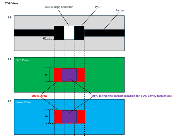

    (3) I understand that the the datasheet 9.1.7 of page 37 and Figure 9-8 of the HD3SS3220 datasheet describe AC ​​coupling capacitors.
    In this section, it is recommended partially voiding the SMD mounting pads of the reference plane by approximately 60% because this value strikes a balance between the capacitive effects of a 0% reference void and the inductive effects of a 100% reference void
    Is this the correct location for 60% cavity formation?
    Could you please see attached Voiding of excel file?

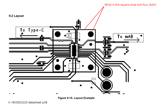

    (4) Regarding Figure 9-10.
    What do the square area and four dots represent?
    Could you please see Layout  of excel file?
    I would recommend the customer looks at our high-speed layout design guidelines app note, this has more information on this: https://www.ti.com/lit/an/slla414/slla414.pdf?ts=1757368993497&ref_url=https%253A%252F%252Fwww.ti.com%252Fproduct%252FHD3SS3220
    These were used in our EVM to allow for a socket to be used to freely place and remove HD3SS3220 units for testing. These can be ignored for a solder-down layout.

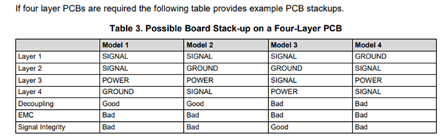

    By the way, the document you introduced mentioned a four-layer board. I think four layer board is possible, though difficult.
    Is this understanding correct?
    In the datasheet and application note(High-Speed Layout Guidelines for Signal Conditioners and USB Hubs), I couldn't understand the reason why 6 layer board is recommended.
    I think that a four-layer board should be fine as long as 9.1.4 High-Speed ​​Differential Signal Rules are observed.
    Could you please advise?

    I looked at the document you specified. The information on page 22 of application note differs from the information on page 37 of the HD3SS3220 datasheet.
    The cavity has changed from 60% to 100%.
    The capacitor size has changed from 0402 to 0201.
    Which information should I use?
    If datasheet(60%) is correct, could you please let me know if the following understanding is correct.

    You can have a power layer adjacent to a signal layer, however the power layer would need to be designed such that there are no power planes directly next to any SS differential pairs, it would also be best to use GND vias to isolate the SS signaling.
    My best recommendation would be to have a GND layer adjacent to signaling layers.
    While it's possible, I'm not sure I would recommend it. As you can see in this table, it's also mentioned that certain aspects of the signal will suffer, such as EMC performance and signal integrity. It's safer to follow the PCB stackups suggested in 9.1.1 of the HD3SS3220 datasheet.
    We recommend 0201 size capacitors for AC coupling, and a 100% void.
