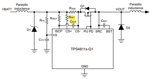

  • Hi Rishika Patel,
    Also wanted to knowif there is any filtering circuit that is needed on the shunt(Rsns).
    Thank you,
    Karthik.

  • Hi Rishika Patel,
    Also wanted to know if there is any filtering circuit that is needed on the shunt(Rsns). The eval board shows a 100 ohm from CS+.
    Thank you,
    Karthik.
  • Hi Karthik,
    3. Yes, the pre-charge path can support 2 back-to-back FETs.
    5. Yes, since VSNS = I_LOAD × RSNS, the load current does affect VIMON accuracy. Please use the equation below from section 8.3.5 Analog Current Monitor Output (IMON) in the datasheet to calculate V(IMON) accuracy.
    9. If you have EMI concerns, connect ferrite beads to the CS+ and CS- pins. It is recommended to have a filter capacitor of 1 nF (CSCP) across ISCP and CS- pins close to the device to prevent false short circuit trips. Are you referring to the 100Ω RSET resistor? That is already part of the basic/necessary configuration.
    Please see section 9.4 Power Supply Recommendations in the datasheet.
