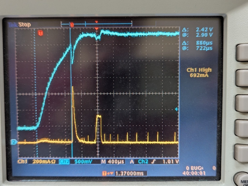

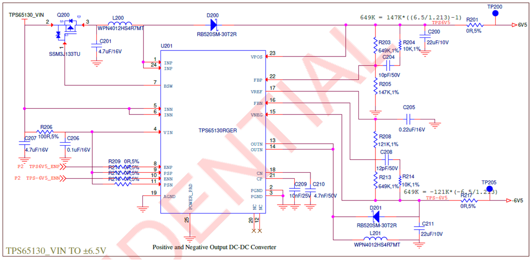

customer feedback the TPS65130 drains high current while no loading.
They needs to control the ENP signal by MCU.

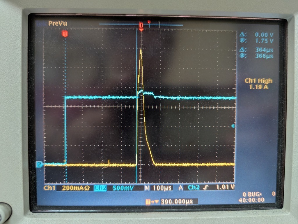

If tied ENP and PSP then will become normal.
Attached waveform for ENP and current waveform. FYI.
Please help to check.
Thanks.
1. ENP controlled by MCU:
2. ENP direct connected with VIN:
