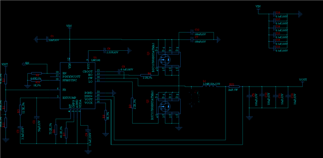

LM5148-Q1: I have a issue about this ic.
Part Number: LM5148-Q1
Other Parts Discussed in Thread: LM5148

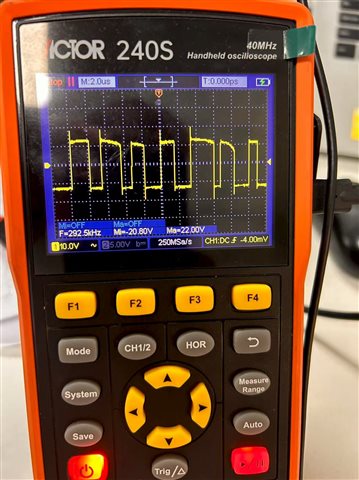

We are currently encountering some issues with the use of LM5148. The input voltage is set to 22V, and the output is configured for 12V; however, the actual measured output is 0V. Even under no-load conditions, the inductor heats up severely. The board circuit is built on an aluminum substrate. Provided below are the SW waveform of the inductor and the schematic diagram.
