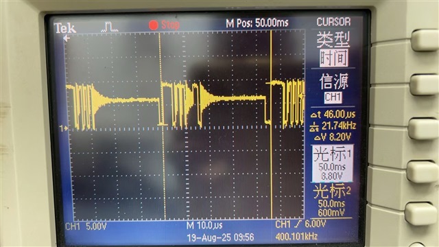

Hi team,
My customer want use TPS62933O(VIN 24V, VOUT 5.5V) which has OOA feature, datasheet specify SW frequency can always be >=30kHz.
But my customer test when device is in no load or light load(50mA), the SW frequency will drop in around 20kHZ as below SW waveform, is that normal? or How we can increase frequency on no load?
