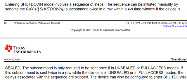

Hi expert,
My customer used to send shutdown command several times, due to they want to double confirm the shutdown command is send out.
and I found in datasheet that we only recommend send once for normal operation.
Q1: if custome want to send several times under UNSEALED or FULLACCESS modes to make sure the command is send out, what the time interval?
Q2: if the device in SEALED mode, what is the time interval we recommend for the two times command.
BR
Emma
  • Hello Emma,
    The device takes around 300-400 ms after receiving the shutdown command before fully shutting down. For multiple shutdown commands, we do not have a recommended time interval for any of the access modes.
