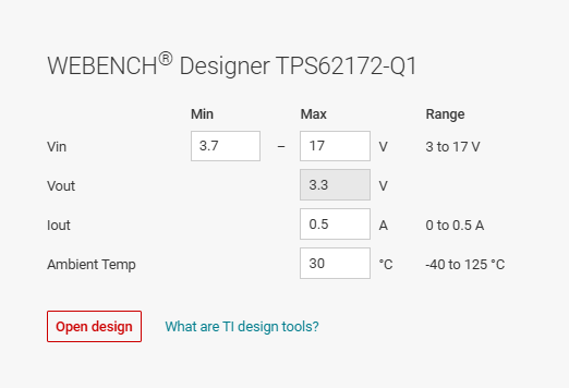

Hello Team,
I have 2 questions:
1. What is the load current threshold at with it enters Power Save Mode Operation?
2. Why is min load current defined in the Web bench?

Hi Anjana,
1. Please go through these two attached screenshots
2. In webench, minimum load current always be 0A for any device. 0A means no load condition.
