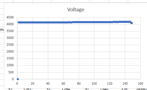

Hello, I followed the "How to Complete a Successful Learning Cycle" document and update the parameters that could be (Design capacity, Taper current, Taper Voltage in my case) and choose the 1202 Chem ID because my battery has nominal of 3.7V with max voltage 4.2V (200mAh capacity), 1202 that was the only Chem profile with adequate maximum voltage. But during chage while being over the Taper voltage and under the charge current treshold, the end of charge is not detected.
What should be done to ensure the end of charge detection ?
